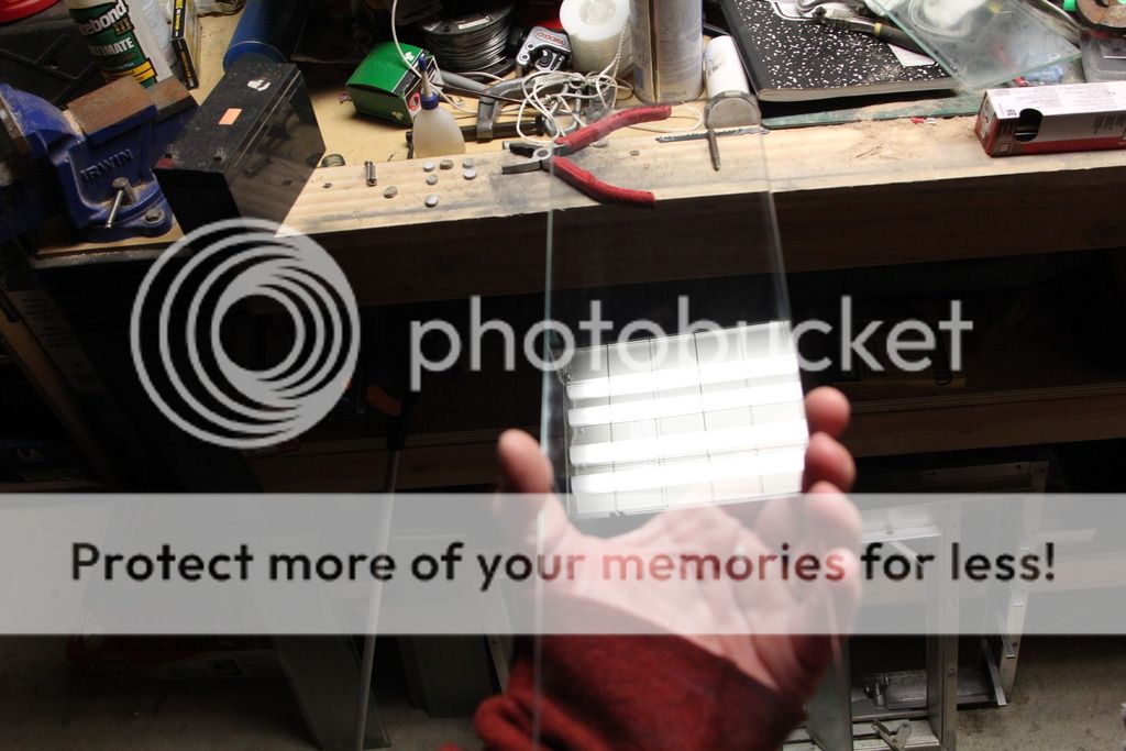

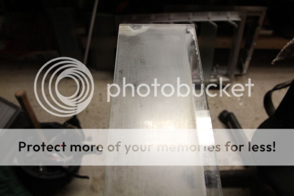

Hey Gang - Reporting back... The nice people from UPS and Amazon got the A-MAZ to me and I started with this: and ended up with this: Looks like A-MAZ has the right combo of abrasives and chemicals to get the job done. A good 5 minutes+ of scrubbing per pane to get nice results but it was the only thing that worked. Thanks for the hot tip Roger!

Hey Gang - Reporting back... The nice people from UPS and Amazon got the A-MAZ to me and I started with this: and ended up with this: Looks like A-MAZ has the right combo of abrasives and chemicals to get the job done. A good 5 minutes+ of scrubbing per pane to get nice results but it was the only thing that worked. Thanks for the hot tip Roger! Holy cow! That looks great. Might be worth gettin some of that just to polish up all the windows. A it really as crystal clear as it looks?
