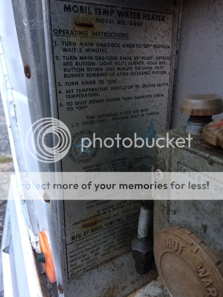

I hope this is the best location for this topic...i've got this HW heater in our "new to us" nomad camper. the PO has bypassed the water heater all together and told me it just needed replaced. i'm wanting to troubleshoot it if possible to settle my mind it's really worth throwing it away. he told me either the unit leaked, or possibly the connections, he wasn't sure... he also told me the pilot wouldn't light. isn't there a shield missing on the right side? anything else missing? is it worth fooling with this thing? i'd really like to stay on gas in case we go dry camping.

The burner is missing.
I'm guessing this tank cracked from freezing and the PO may not have known that. They start to leak like crazy when pressure is applied. Also, somebody added a new drain to the tank, a little late, IMO.
In any case, it's not worth messing with.

Thanks! makes sense now that you say that, there isn't anything in there! i'll start looking at options. is it worth trying to setup both electric HW and propane?
