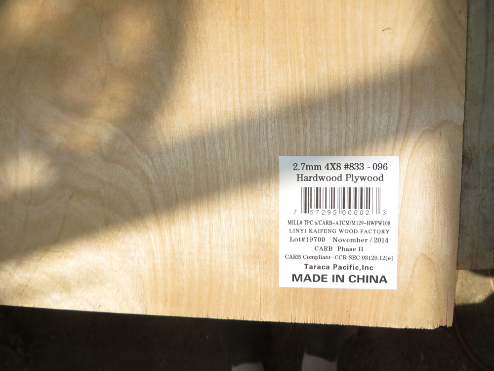

Siwek Lumber Northeast Minneapolis, MN Don't know cost on the 1/8" birch but they definitely have it. As well as what looked like walnut and ash. Ask if it is from China. If so don't buy it and tell them why you won't buy it. The veneer delaminates at the seams AFTER you apply shellac. And there is no repair for it. Here are some photos... I make mistakes so you don't have to.... ![http://www.cannedhamtrailers.com/forum/seam/panel1.jpg](http://www.cannedhamtrailers.com/forum/seam/panel1.jpg) ![http://www.cannedhamtrailers.com/forum/seam/panel2.jpg](http://www.cannedhamtrailers.com/forum/seam/panel2.jpg) ![http://www.cannedhamtrailers.com/forum/seam/panel3.jpg](http://www.cannedhamtrailers.com/forum/seam/panel3.jpg) ![http://www.cannedhamtrailers.com/forum/seam/panel4.jpg](http://www.cannedhamtrailers.com/forum/seam/panel4.jpg) ![http://www.cannedhamtrailers.com/forum/seam/china.jpg](http://www.cannedhamtrailers.com/forum/seam/china.jpg)

Ask if it is from China. If so don't buy it and tell them why you won't buy it. The veneer delaminates at the seams AFTER you apply shellac. And there is no repair for it. Here are some photos... I make mistakes so you don't have to.... I'd listen to this man. This is the same label and brand name, Taraca Pacific, that was on the plywood I first bought to build my trailer floor. After becoming worried about it's water resistance, I tried soaking it which didn't seem to cause any problems. I then tapped it lightly on the floor and the wood split apart and I then proceeded to tear the layers apart with my bare hands. Whatever this company is using for glue on this plywood is not bonding well, and the wood they use on the inner layers is like balsa. ![](http://i.imgur.com/6GY3L7m.jpg) ![](http://images.tapatalk-cdn.com/15/10/25/c165c5177fa5dc151e17448cd6650650.jpg)

Unfortunately, the sales people don't know where the birch comes from other than it's imported. As a rule, when they say $20 a sheet, it's probably imported. Domestic seems to cost double...if you can find it. In my home country of Ireland we have a saying: When ten people tell you you're drunk, you better sit down. Vintage camper translation: When Mobiltec and vikx tell you to avoid imported birch (China especially), just do it. ![;)](//storage.proboards.com/3684717/images/ngt5cVS1HUGV44UpTqYc.png)

What ever the Chineese are using it is not glue I can tell you that. Never before had I seen plywood I can delaminate with my bare hands. Extremely thankful I figured this out before using any of it in my trailer project.
