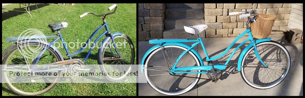

Not only have we been working on our trailer but we have been rehabbing two vintage bicycles. I got mine at a flea market for $5.00. It turned out great and rides great too.
Before & After
Post by SusieQ on Mar 24, 2015 6:20:41 GMT -8
Wow, what a deal, a real steal! It looks great!
