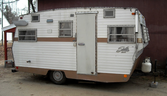

I picked up our 1971 Airflyte in Merrimack NH in December of 2010 for $100
Here's what it looked like~

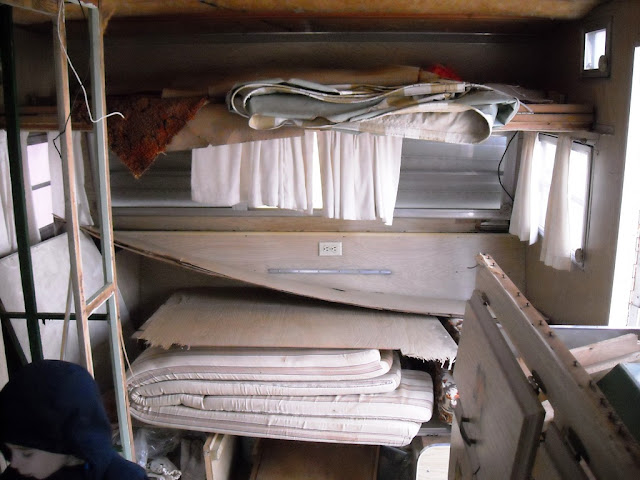

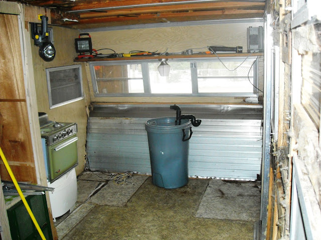

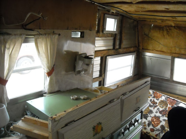

It was not the kind of camper that a weekend of 'paint and TLC was going to fix, so I decided to
gut it and start from scratch. I had never done anything like this before but I'm relatively handy
so I started tearing in to the job..
Note the floor color difference..yuk!
Also note the lack of framing on the front wall.. it was just a pile of rotted wood dust.
I wondered if it was even possible to fix up at this point, put I soldiered on.

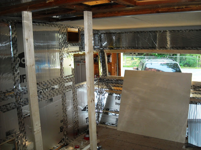

I got myself a Kreg tool / jig and started removing rotted wood and reframing.. I probably
replaced half the framing in the camper..
I made a little demonstration video of the Kreg tool that seemed to be helpful to folks
on the other forum, maybe a new person here will find it useful too~
Lots of framing later I put down the new subfloor...

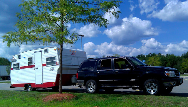

Here it is once the painting was mostly complete... windows had been removed,
cleaned up and installed with new sealer tape and the wings were refurbished as well.

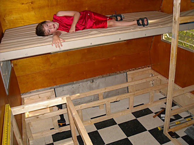

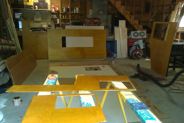

Then it was time to get busy with Birch.. I'm no carpenter, but things went pretty well.
Despite not having the kitchen or rear couch/bed area done we took it on its maiden voyage in
September 2011 to the Historic Races at Lime Rock Park in Connecticut.. A great time was had by all.

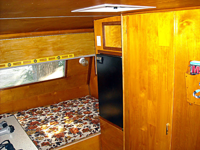

We've used it several times over the last year and a half and the rear portion of the interior is
completed..
We've been having a blast with our old Shasta.. still a work in progress~
