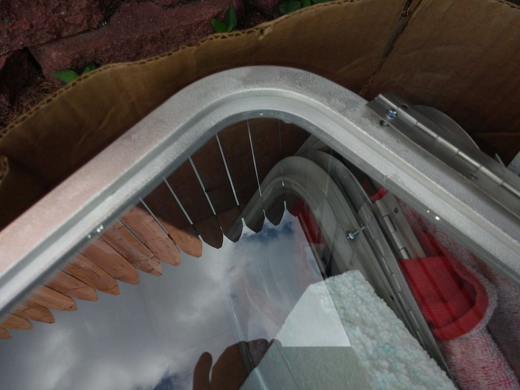

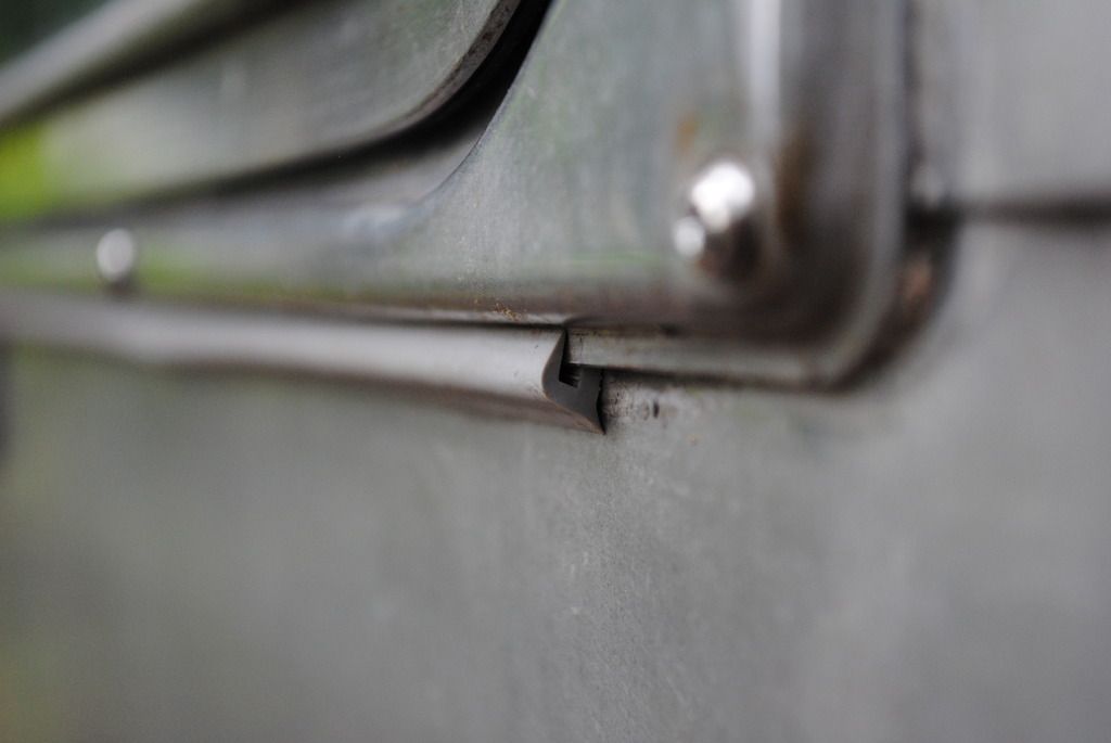

Hi Lee, this is the link from Robert's shop: www.vintagetrailershop.com/windows-and-gaskets/112-hehr-standard-glass-seal.html I haven't tried it yet, that's a photo he sent me. I screwed my windows in temporarily without putty tape and didn't have an issue with them collapsing. We had to screw them in pretty tight too to get the windows around the curve. I wonder if we're talking about the same windows? The more experienced members may have more insight, but my understanding is that putty tape is pretty essential to keeping water from leaking through the windows, so I'm not sure you want to forego that.
Post by whalensdad on Jun 20, 2016 11:52:15 GMT -8
We definitely have the same window. If you notice the frame under the screw is recessed about 1/4 inch from the actual back of the frame. Either something seems like it goes in that 1/4 inch channel to prevent the channel from collapsing when I screw it in or I'm doing something wrong.
Dummy me, I thought the GREY gasket was the new one.

Post by windborn on Jun 23, 2016 7:23:10 GMT -8
That's interesting. I haven't had that problem. When I take my windows off I'll take some photos to see if there's something different about the back of my frames making them sturdier.
I'm not sure what the grey gasket is in that photo. But the black one is the one Robert sent samples of and has available now. They arrived the other day but I haven't had a chance to try them out.
Post by whalensdad on Jun 24, 2016 17:14:16 GMT -8
The grey is the original side gasket. I had to remove my original ones because they were in very bad condition. I just got in the grey version of the black seal that Robert displayed.
What did you put between the frame and the trailer skin to keep a water tight seal?

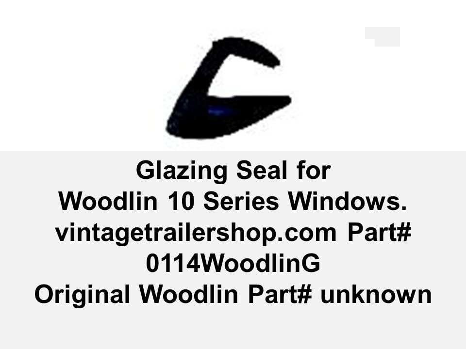

That's great! I tested the Hehr seal last night and it does seem like it will work. That's a bummer about the broken glass. I hadn't even considered that issue when it comes to replacing gaskets. What are you using for the window glazing? This is the closest thing I've found to what I have in my windows, but it doesn't look quite right. www.vintagetrailersupply.com/Hallmark-12-Glazing-Strip-p/vts-890.htm Then again I haven't gotten a good look at what I have yet. I've been afraid to take the glass out for fear of getting it back in. And now I'm afraid I'll break it too.

Post by windborn on Aug 7, 2016 4:42:07 GMT -8
Wow, that stinks that all the windows were broken, but I'm glad it worked out in the end. I'd love to see some photos! Fwiw, this is the glazing seal that Robert at Vintage Trailer Shop is in the process of making. Though the possibility of breaking the glass makes me hesitant to replace this on my own.

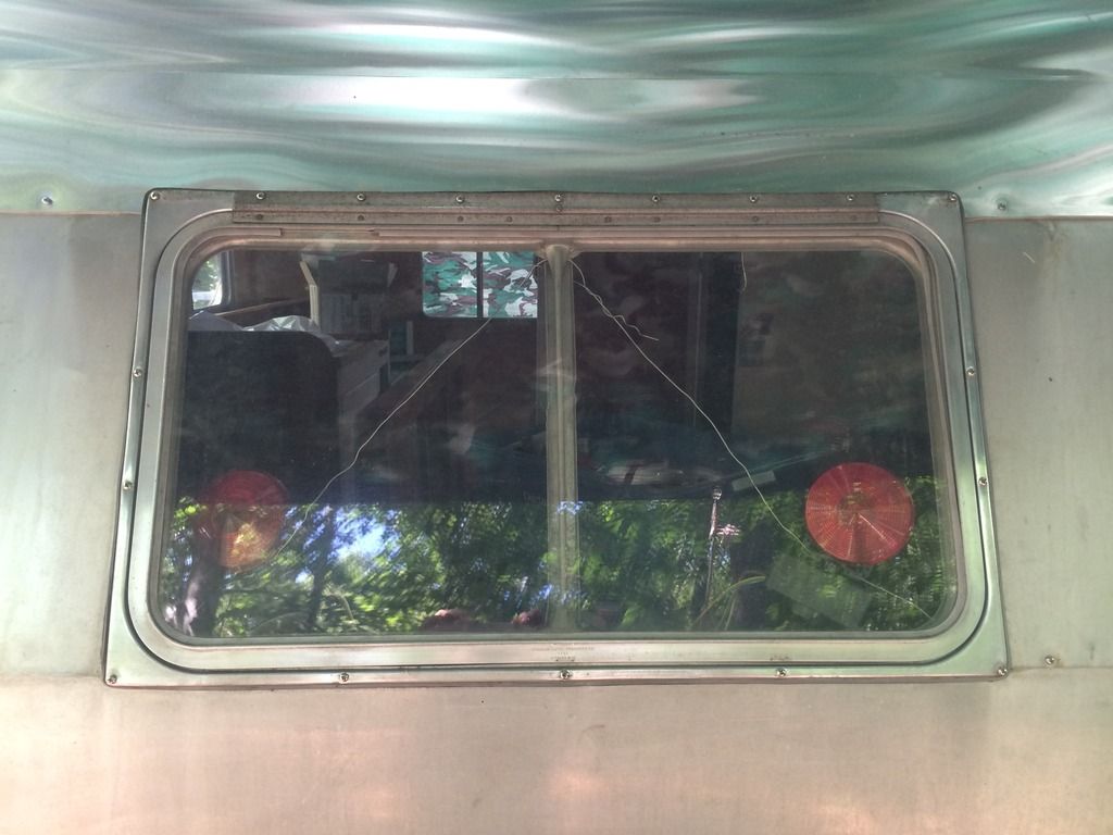

Post by whalensdad on Aug 20, 2016 13:49:53 GMT -8
Here are pics of the windows.

Post by windborn on Aug 22, 2016 5:54:57 GMT -8
Looks great!

Post by robert14 on Dec 18, 2016 11:33:43 GMT -8
One additional note about this window. You will have to dismantle the window to replace the glass and/or glazing. There is just no way to insert the glass and glazing without taking the window apart. Robert
