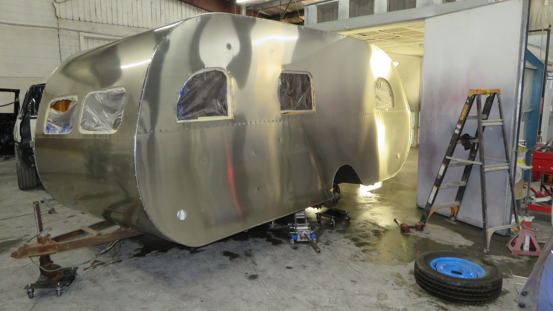

Off to the paint shop for two coats of Toon-Brite Clear Coat. Clear coat to keep the aluminum from oxidizing? Locally? You did the prep on this one. We did all the prep we could. We masked too. The painter will do one more cleaning on it. He will also metal prep the raw aluminum door. I have already acid washed it and scotch brited it. Raw aluminum needs a prep right before paint. (Clear Coat). And yes the clear coat is actually mainly for UV protection. The mill side of the aluminum already has a clear coat to keep it from oxidizing but it is not UV resistant. So we used Toon-Brite clear coat which is UV resistant. They will need to apply a new coat every 3 years to keep it this way.
Posts: 9,825
Likes: 3,752
Post by mobiltec on Feb 14, 2021 7:20:55 GMT -8
Here it is going into the paint booth. We had to take the wheels off and put it on dollies to get it as low as possible. She's there right now and I'll most likely get her back Monday or Tuesday. The stickers will be mounted as well under the clear coat.

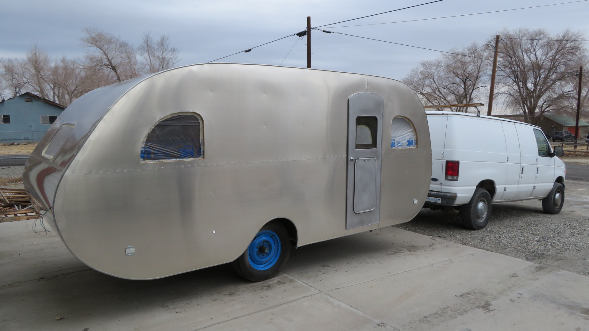

The 48 Mainline Silver Lodger is ever so slowly coming along. She's almost there. Installing glass now. This is how she sits today. A good old skydiving friend of mine made the Winged Silver Lodger emblems. So if you know anyone who needs emblems send them this way and I'll send them to my friend Kelly.... Larger Photo: www.cannedhamtrailers.com/forum/47mainline/asoftoday.JPG
