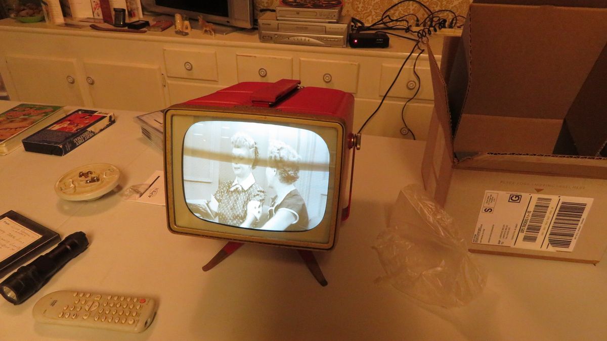

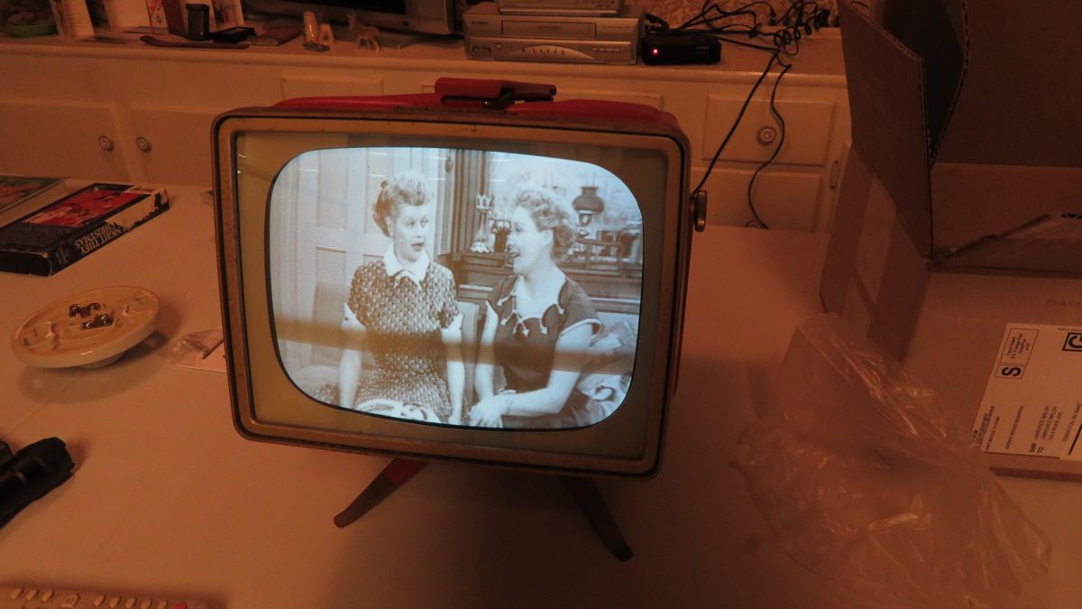

Post by danrhodes on Dec 23, 2019 21:00:40 GMT -8
I got my 1954 RCA Victor Desktop TV working real good. I also have all the episodes of I Love Lucy on DVDs. So this tv will be displayed in my 54 Jewel and playing I Love Lucy episodes at the rallies... I'm also finishing up the last of the cabinets on the jewel so I'll be building new walls next. Then once the walls are up the wrap goes on and we're in business. Photos of cabinets soon. That's really cool... What did you need to do to get the TV working? Is it a tube TV?
