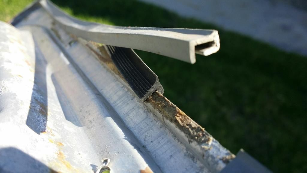

ndpap, did you ever find gaskets for your Woodlin windows? The only other things I've found online are other people looking for help. I'm currently looking for the gaskets on the frame (backframe gasket?), though I may find out I need the cushion & the glass gasket down the line. John, here are some photos: I can get a cross section shot of the gasket I'm referring to soon if you think you may be able to help. It looks similar to the Hehr Standard Glass Seal on VTS, but about half the size.

Yeah, that gasket looks like it may be a replacement for what I've been calling the "cushion." Though I've been unable to find anything that matches the ones that edge the frame like this: Here's a cross-section: And a size comparison: I'd keep the old gaskets if I could, but one of them shrunk enough to slip down at some point in its life. And then I ripped it all off. If no one here has any ideas I'll get in touch with Vintage Trailer Supply and see what they have to say.

Robert sent me this picture this morning of how the Standard Hehr Seal looks compared to the backgasket frame. Could work?
Post by whalensdad on Jun 20, 2016 3:49:41 GMT -8
Those look like they may work. I originally tried to attach one frame using butyl tape but fund that if you screw down too tight the aluminum channel collapses and deforms the frame. What a stupid design. I purchased a neoprene gasket that will fit in the channel which I'm hoping will provide some structure. If this gasket along with what you show above works, I may be able to forego using butyl tape at all. I don't have the time to wait for someone to make a product.
