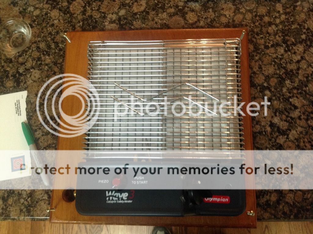

Post by msgoehring on Apr 7, 2017 20:42:42 GMT -8
It's not in my trailer, but it is what we plan on doing with ours: 132_zpsea9c1910
Post by vikx on Apr 7, 2017 22:02:35 GMT -8
Wave 3s are NOT to be inset, according to the manufacturer. With a special metal insert, the 6s can be inserted. With a small vintage trailer, a Wave 6 will COOK people.
I am not against the above install, but the corrugated yellow gas line is not legal in any RV. Modern code dictates black iron under the trailer, copper up into the trailer and to the appliance. Rubber hoses are also not allowed inside.

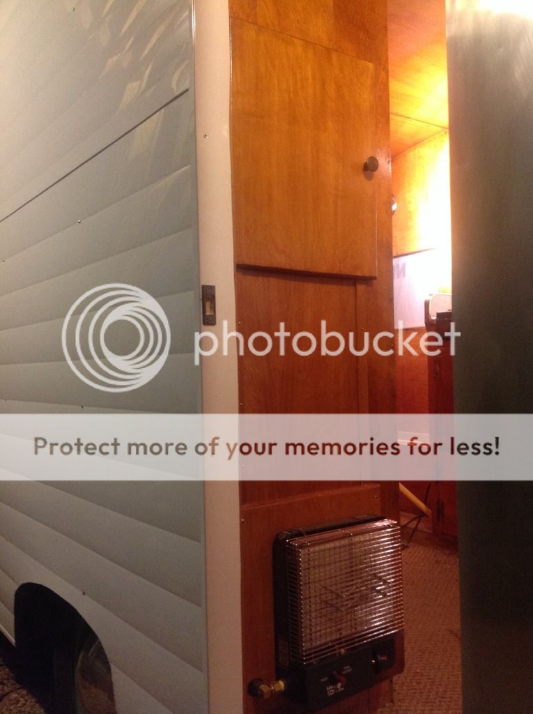

Post by nccamper on Apr 8, 2017 5:23:52 GMT -8
Here is our wave3. I removed the original (large) heater and put in the wave3 with a cabinet above it. It puts out plenty of heat and will cook you if you don't let the camper temp drop below 30 degrees. If you wake up and the camper is 25 degrees it takes a long time to recover. So Canada may need more heat than NC. It radiated heat so whatever it's facing warms up fast. In our case it faces the dinette. Wave 3=3000btu Wave6 =6000btu Mr. Heater=9000btu We have a Mr. Heater and it gets in the way inside a small canned ham but it sure warms things up...instantly.
Post by ladywendolyn on Apr 8, 2017 6:22:19 GMT -8
Do you find that with the heat facing the dinette, the rear gaucho area will eventually heat up?
Post by nccamper on Apr 8, 2017 8:02:43 GMT -8
Do you find that with the heat facing the dinette, the rear gaucho area will eventually heat up? In a freezing camper...Eventually. It also really depends on your definition of "heats up". My wife says over 50 is warm and I say over 70. Facing the middle of the camper makes the heat distribution better but unless it's hidden like above it may get in the way. I have family that lives where the winter temp can reach -10 degrees. Trying to raise the temp in a camper 80 degrees needs some serious BTUs. Others may disagree, but I think them wave3 can raise the temp 40-50 degrees max and it will take over an hour in the rear away from the unit.

Post by chametzoo on Apr 8, 2017 9:24:39 GMT -8
Do you find that with the heat facing the dinette, the rear gaucho area will eventually heat up? Lady W… Mine is mounted exactly like NCcamper's, but we used a piece of aluminum as the backing against the wood of the wardrobe. Mounting the Wave near the entrance acknowledges that this is most likely where heat loss takes place, which like in residential radiant baseboards, you place them under windows and other heat loss exposures. It's also important to know that Waves emit purely radiant heat with a limited spread. So, like a flashlight, the heat beam heats mostly where it is pointed and in a limited spread. So you will feel the most warmth and comfort while sitting at your dinette table. That's not to say that one heated air molecule will not transfer heat to its neighbor and heat the entire trailer interior, including your sleeping area. I have measured temperature near my bunk and the temp does indeed increase the ambient temperature significantly, but it certainly doesn't feel toasty like up front. So that's the difference you will experience front and back. There is no open flame with a Wave, but it does consume interior oxygen. Most of our vintage trailers are anything but “airtight”, esp. if you have jalousie windows, but cracking your ceiling vent and one window a tiny bit is a cautious approach while sleeping.
Post by ladywendolyn on Apr 8, 2017 14:51:13 GMT -8
Has anyone tried using a fan to "blow" the warm air around, or does that not work with radiant heat? Sorry if these questions sound a bit naive, but in Canada where I live we pretty much have massive furnaces in every trailer, so I am unfamiliar with this technology, but I won't be using my vintage trailer except during the summer and maybe into the fall. The lowest temp will likely be about zero degrees celsius, which I believe is 30 degrees in the usa.

Post by chametzoo on Apr 8, 2017 15:44:46 GMT -8
Has anyone tried using a fan to "blow" the warm air around, or does that not work with radiant heat? Sorry if these questions sound a bit naive, but in Canada where I live we pretty much have massive furnaces in every trailer, so I am unfamiliar with this technology, but I won't be using my vintage trailer except during the summer and maybe into the fall. The lowest temp will likely be about zero degrees celsius, which I believe is 30 degrees in the usa. 30 degrees will still require some significant heat inside the trailer. I believe the Waves can be mounted on feet and moved around your trailer. You would just need to have gas supply lines in the likely places you would want the brunt of the heat. I had considered mounting a second Wave (across from my bunk on the exterior of the bathroom wall only about 15" from the side of the bunk). But that kind of proximity would make you sweat!… so I thought better of it. If it's that cold I get in a sleeping bag and as I said in my previous post, the front mounted Wave definitely gives you a reasonable ambient rise in temperature in the back bunk area… that plus a good blanket (or a “bunkmate” ) in the fall season and you'll be very comfortable. The whole idea of active heating in a small trailer is mostly there for when you're awake and active so you don't have to walk around inside with a parka on, not so much as a heat source for the whole night. But I wouldn't hesitate to run mine at night if I felt I needed it while sleeping. A fan will consume electricity, if you're off grid, make noise and create a barely lukewarm draft, which you don't want when it's cold! IMO.
