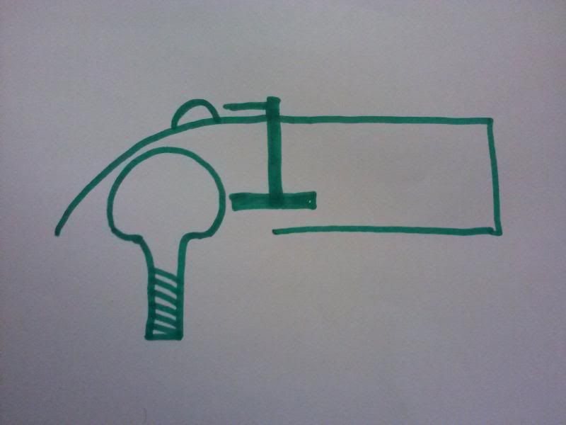

I dont know if im posting this is the right section but here it goes.Today my fiance and I went to buy a rehab camper. It looked like a shasta but the guy didnt have any info on it nor did it have anything written on the sides of it. The problem was the trailer hitch. We tried a 1 7/8 and a 2 inch. It seemed like the 2 inch had way too much play and the piece that locks it in didnt fit for either. The locking piece was made for a flat or mushroom shaped ball hitch by the looks of it but i cant find anything out about it. The owner wasnt sure as it was giving to him and he hadnt moved it because its on his camp the grounds that he owns. We cant figure out how to get it home unless we get a sway bar. the piece you use to turn it is more like a key in the way that its only a 1/4 of a turn. but still... when you turn it, it hits the middle of the ball. theres no rust or damage to the coupler. If you dont know what coupler issue is, do you know what kind of camper this might be? The diagram below is what it looks like, except the ball sits flush, no rust, no damage. Its as if a mushroom shaped ball is needed. Also take into consideration my fiance has had boats and utility trailers for years. This isnt his first rodeo. WE ARE STUMPED!

WELCOME to VTT!! Some close up pics of hitch might help too. Clean off top of hitch with wire brush or sandpaper right in front of jack. There should be some stuff stamped into the metal there like weight limit of hitch etc. It should also be marked for what size ball it actually takes. Also the ball lock might need adjusting in side hitch. Usually bolt head on top. Maybe the front nose of the hitch suffered a downward impact from something and bent the nose tip down to not allow ball enough clearance to go far enough up into hitch?? Would love to see couple more pics of more hitch, less trailer LOL Spray kroil all over up inside hitch too. Can you get a couple more close up pics of the hitch and under hitch?

It didnt take a blow to the top, there isnt any rust, I even looked myself. Other then it isnt lining up... its in perfect condition. Its an hour and a half away and I didnt think to take more pictures. There arent any markings on it either. If i didnt know any better I would say its homemade but its not....
