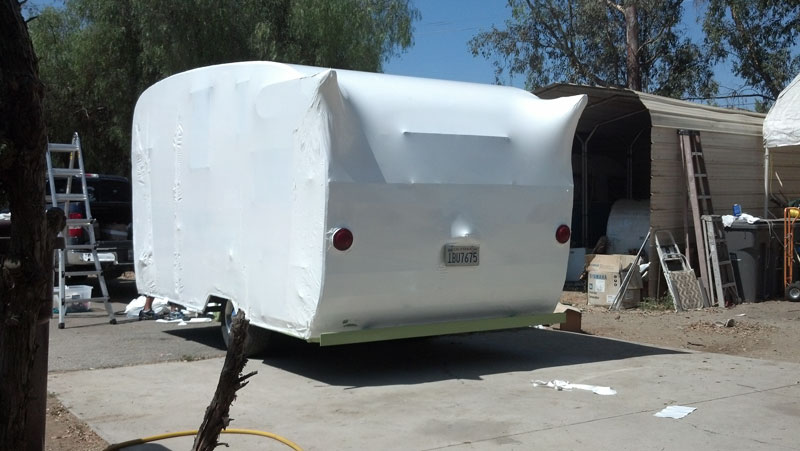

No matter what you do short of shrink wrapping the entire trailer Jalousies will leak when driving in a rain storm.

No matter what you do short of shrink wrapping the entire trailer Jalousies will leak when driving in a rain storm. I am so tempted to post this photo on Facebook with a title "Trailer for sale, no leaks".. lol

No matter what you do short of shrink wrapping the entire trailer Jalousies will leak when driving in a rain storm. Due to very specific aerodynamics, it's the front and rear windows that have the most potential to leak. My side jalousies never leak. Updraft emerging from under the tow vehicle help the front to leak and the same emerging from the back of the trailer do the same for the rear. The airflow curls abruptly upward from under either vehicle before dissipating. Add water to that… and you have a mess. The shrink wrap for the front windows is not a bad idea for those rainy occasions. I think they sell it at Home Depot for insulating drafty windows. Plastic wrap + some hot air from a blow dryer. Wonder if that would withstand the airflow while traveling.

The kitchen and bath sealant did not keep them permanently on, and if you like to keep them looking clean, the kitchen and bath sealant stuff is not the greatest but is better than nothing at all. I'm looking for an alternative and will share if a better plan comes my way. Cheers, Poquito Tough choice: dirty windows or wet interior. Further back in this thread, Mobiletec made a joke about just shrink wrapping the whole trailer, but I think he is on to something. Even after applying the glass strips, I still had problems with water coming in those front windows, not between the glass panes, but through the frame itself. With the air rolling over the front of the trailer, there is a big pressure differential and the water will be sucked through even the tinniest of openings. On close examination the jalousies frames which are assembled from many parts, have lots of gaps and pinholes that the glass strips do not address. So, I decided that the only solution was to completely cover the front set of three windows on my '60 Mobile Scout when traveling with rain expected. So what would that look like? At first I would use a piece of clear plexi with a rubber gasket around the perimeter that would press onto the surface of trailer and seal off the windows from water and air flow. The challenge was how to get the plexi to attach. I came up with a couple of solutions, but before I fabricated this thing I got an easier solution a la Mobiletecs shrink wrap joke. When traveling in rain, prepare the windows with clear heavy mil plastic and secure it to the trailer skin with a non glue residue "duct" tape. I tested the tape and found that it did perform well in terms of not leaving any glue residue. If you've got a good paint job it certainly will not pull any paint off the skin. So, this is a temporary, rain only application. When you arrive at your destination, you just rip the whole thing off. The plastic can be reused for next time and you keep a roll of that tape handy. Now... I haven't tried this in practice yet, with low rainfall this summer in NM... but I think it is promising and also easy to apply and remove. Just taking the jalousies out of the equation is my solution

Sealing up a trailer with a plastic shrink wrap is not a good idea if your plan is to transport the trailer. Just call Flyte Camp, and ask the Justine Scribner what he think's of shrink wrap when towing a newly polished and rebuilt (very high $$$) Spartan Manor cross country. Moisture and dust collected under the plastic, the wind of highway travel then abraded the newly polished skin to the point that they had to re-polish ( a BIG JOB) the entire trailer before they could deliver it to the new owner.
