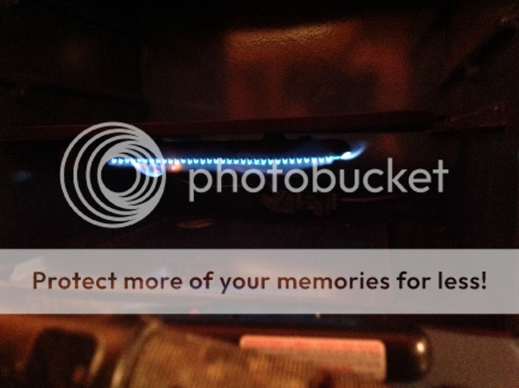

Post by nccamper on Apr 25, 2016 4:05:49 GMT -8
Update. I got the oven working thanks to parts from Trailertrasher. He send me basically everything from the valve to the burner. Since I replaced all the parts at once I can't be sure which one was bad but my guess is the temp thermostat up top. I highly recommend Trailertrasher is you need vintage parts. I've bought from him several times and I've never been disappointed. With that said, the oven is something I'd only use in the winter on a very cold day, with the windows open. It heats the camper to crazy-hot in minutes.

Post by vikx on Apr 25, 2016 21:54:29 GMT -8
If the pilot doesn't "flare", it's usually the top oven valve. Great that it works and thanks for posting!
Post by Ten on Apr 26, 2016 2:26:44 GMT -8
There is not much better feeling than when the burner lights up, and there are not flaming pieces of debris flying around the yard. Congrats, nc, that oven looks good all lit up. (From the photo it looks like it's pretty nice condition, and looks good even when not lit.)
