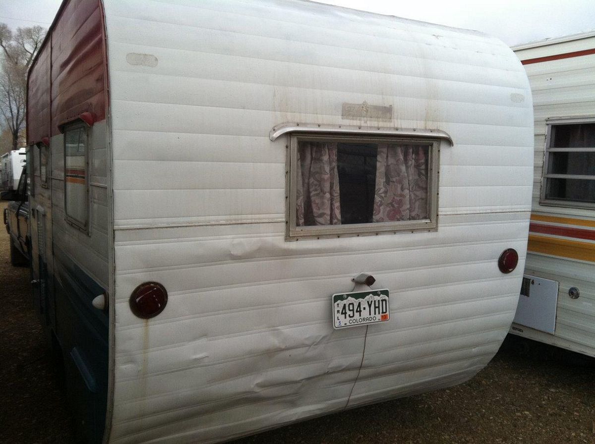

Just thought I would show you how good new metal looks when it is installed properly. These are before and after photos of the 59 Forester I did in Colorado last month. The metal matches the other lower side and front metal. I don't know why they did the top in regular 4 inch breaks and then switched to this pattern for the lower part of the trailer but that's what we wanted to match and match it we did. This metal was made at Hemet Valley RV and Siding in Hemet California. It was the first time we ran this particular pattern and it worked out great. Notice the "Puff Factor" in the new metal...

Mobiltec I like the wrinkles and dents better The new skin really looks nice Hemet Valley did a good job of reproducing the pattern

i think it looks sweet...nice job with the radiuses...your the man.

i think it looks sweet...nice job with the radiuses...your the man. The use of a block of wood to hold down the metal while banging and stapling the fold-over in is what does it.
