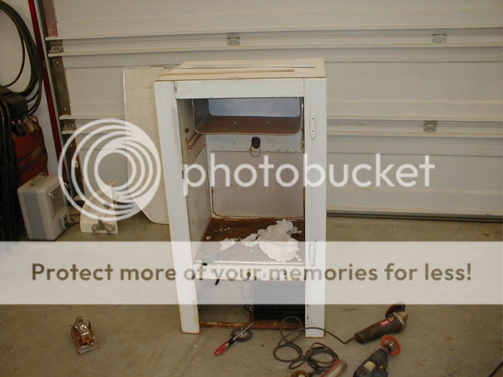

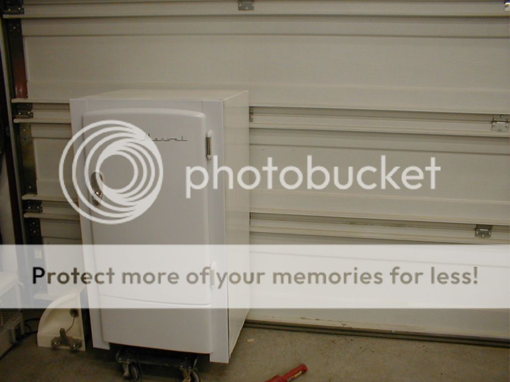

Post by ben on Mar 1, 2014 13:19:47 GMT -8
the marvel fridg i have did work so i just cleaned it up and re painted it i just used the tools you see laying on the floor. the fiber wheel on the drill seemed to work the best, from harbor freight i used rustolium spray paint from home depot appliance white

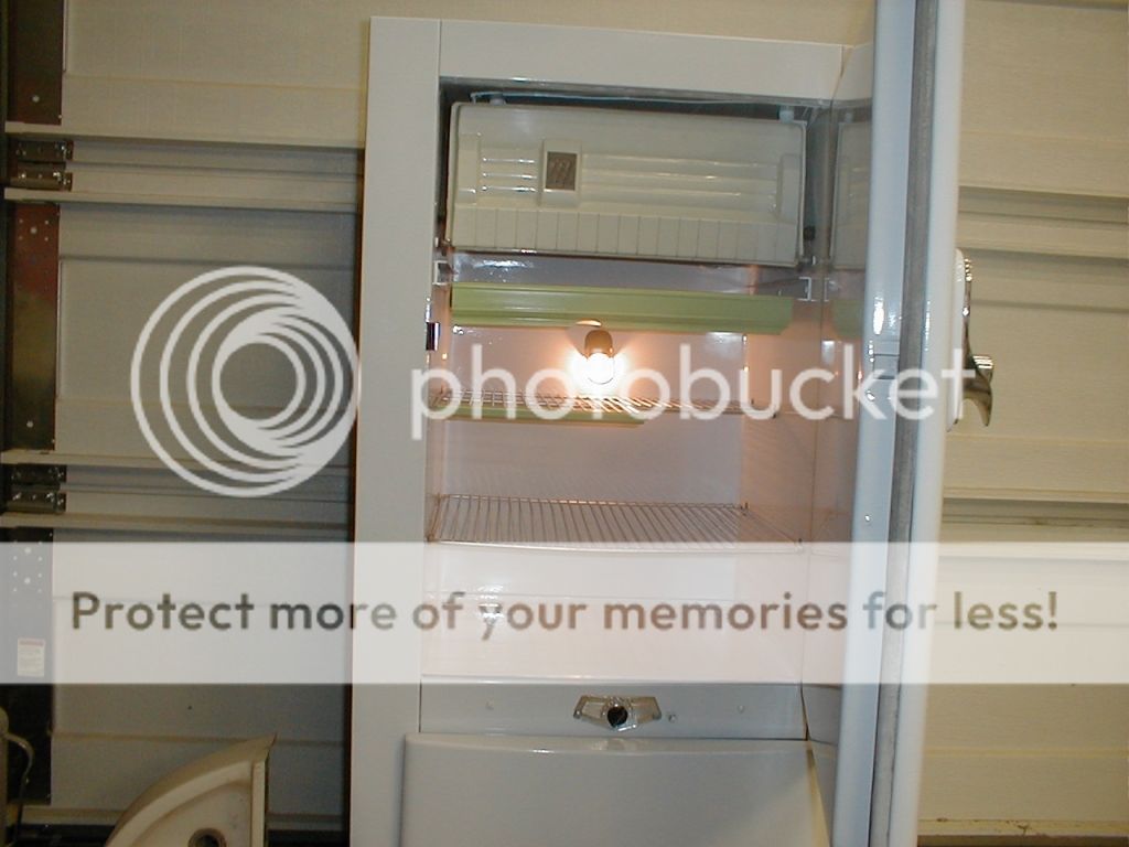

Wowee! That looks great! The Compact's ice box cleanup is next on my punch list. Is the inside of the Marvel metal or plastic? The Compact's is plastic -- is it paintable?
Post by SusieQ on Mar 1, 2014 16:11:53 GMT -8
Ben, that looks marvelous! pun intended Newmexgal, mine is all metal! Not sure if tray is original, just assumed it was. Icebox Inside
