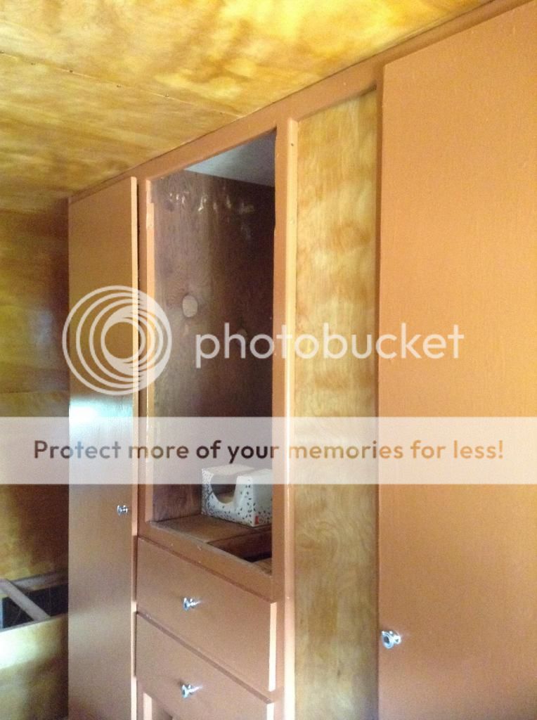

Hi, I am also stuck on the cupboards in my trailer. After replacing the original vinyl covered hard board ceiling and nasty panelling with shellacked birch , I really would like birch cabinets as well, even though there was no birch at all in my camper to begin with. After spending months fixing stuff no one sees, I decided to paint the existing cabinets, put on new hinges and leave the cabinet replacement until the winter. I couldn't find any pictures of birch walls with painted cabinets, but I need to have her in useable condition by the end of July, and there is still a lot to do. So, I found paint in a ginger color that looks ok with the birch, bought a counter top from a big box store and put the cabinets back in. I can use her this way this summer and rebuild the cabinets over the winter. It really doesn't look too bad for now. (My cabinets were not birch and refinishing really wasn't an option.) Cheri Before Now

Ok, I have to confess. I do really like some painted interiors. My trailer was nasty when I got her. She was painted baby blue with high gloss royal blue trim. The ceiling and front and back walls were vinyl covered hard board. I didn't even take a picture before I toned that down with cream and carmel colored paint. While I couldn't stand that blue paint job, I would have been happy to just replace everything with lauan and paint it in neutral colors. I asked my husband his opinion, and he thought the birch would look better. Once I started shellacking, I fell in love with the wood but.... I do like the light and airy feeling that some of the painted trailers have. In my case, I am replacing fake wood paneling and a counter top and table that are not original. I'm not really doing a restoration, more of a rehab. This is probably a good thing as the trailer is going to be infested with teenagers at the county fair in July. I think I would be afraid to use one of the beautifully restored trailers I see here. As I may have the only Vanbrook trailer in existence, there is nothing to compare with anyway. Just my two cents. Cheri
