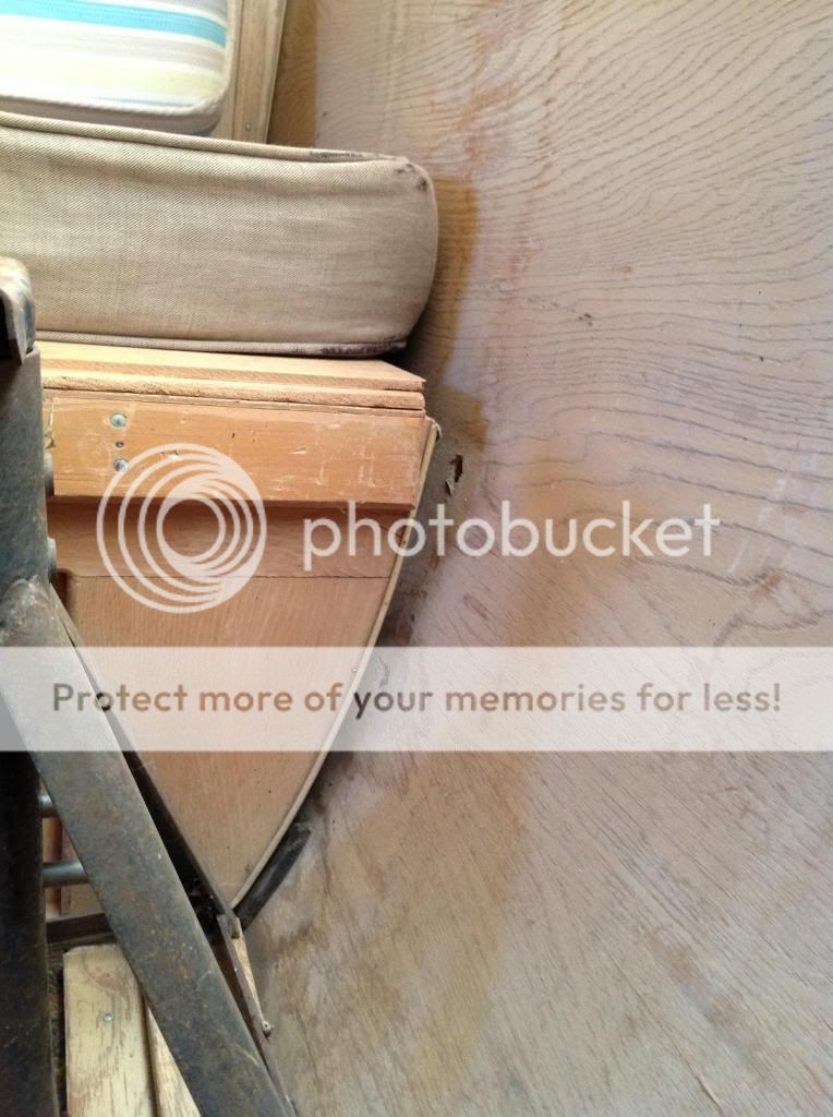

I picked up our 1962 Shasta compact in Utah a couple of days ago. The ash wall panel is nailed to the inside bench. It has separated (long ago) and I was wondering if it matters. The wood at the bottom passed the ice pick test and the next cross support (solid wood) seems to be just below the window. There does not seem to be any board behind where the nails came loose. I re-watched the Shasta Mobitec videos with the Shasta rear wall open. There is nothing where these nails came loose to anchor them. Does anybody have Compact rear wall photos (rear skin off) so I can see if there is something there to nail a temp support to? Or is it not an issue?

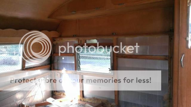

Here's a pic I saved of some original early compact rear framing. I have a couple more pics that show rebuilt trailers with the same exact framework. And a couple that were beefed up. This is probly as close as it will get. It really wouldn't bother me to tow it that way, if it's fastened well below. But others may chime in. Enjoy the trip!

Here's a pic I saved of some original early compact rear framing. I have a couple more pics that show rebuilt trailers with the same exact framework. And a couple that were beefed up. This is probly as close as it will get. It really wouldn't bother me to tow it that way, if it's fastened well below. But others may chime in. Enjoy the trip! That photo helps a lot. As I suspected, there is nothing from the wood below the window to the floor. Any other framing photos on the compact would be really appriciated.

But it should fit snugly against the benches. You should not have a gap here: Here's a view from under the bench of the back wall looking through the baggage compartment. Oops, see where my nail missed? Mine fits tight at the bottom but has bowed at the top of the bench. The nails came through the ash panel. The wood below the window seems solid but bowed. I'm considering running a sister board across (the board under the window but above the bench) for support. Suggestion?

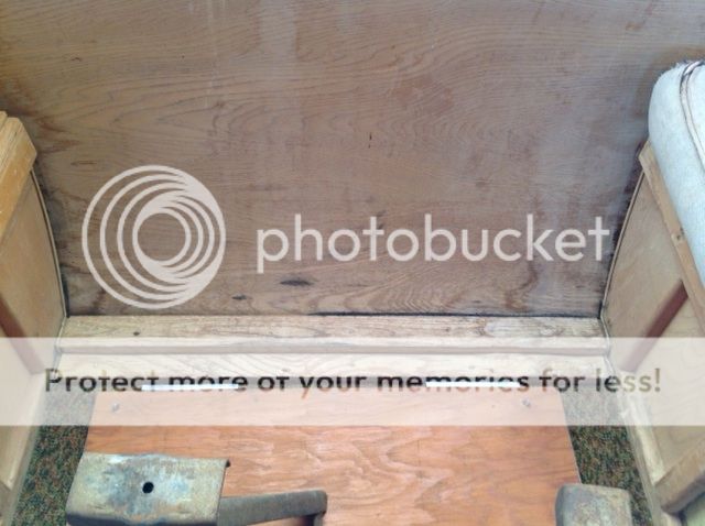

NC, if the panel is secure at the bottom, (mine was rotted), and everywhere else, I think you should be OK. It has the framing board under the window and one more below it and one at the bottom that is holding the panel in and holding the sides together. I would be more concerned about the framing, skirting and curbing being solid. If those framing boards running horizontal across the back panel aren't nailed into something solid, then you have a problem. Look in the baggage compartment and under the bench on the other side and see if the panel is secure. I know I don't think like everybody else, but if I did anything, I'd run a temporary board across the benches. The inside is what holds the outside together. The framing along the bottom seems solid. The board across the bottom inside the luggage compartment is solid (photo). The odd thing is the bow seem only in the middle between the supports. The bottom board and the one below the window appear straight and solid but you can see the small bow between from the outside. It's almost like a child may have kicked the wall under the table. I think your idea of a board running across the top of the benches seems smart. You would go straight across the top from side to side? Before I left NC I cut a 2x4 angled with my table saw for just such a support to take into account the angle. I also ripped a couple of 2x4s (down to 3 inch) for extra support for the frame if needed, but those seem fine. My truck looks loaded by a madman for any issues that might come up.
