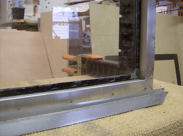

Post by SusieQ on Jan 15, 2014 8:49:21 GMT -8
susieq, looks like me and you are in the same boat. i just asked larry about this over the weekend. unfortunately, mine is missing the metal strips. so if you can stretch yours to make two sets id appreciate it lol. good luck, even though i am a pretty good carpenter, i will say i have found some supprises this week when i started taking some skin off. Here's one out of a '68 Compact on eBay Buy It Now price $115 or make offer Says it has all the trim. I know that would be a last resort but just thought I'd let you know about it. Has dimensions listed, too. www.ebay.com/itm/Vinatage-Shasta-Scotty-Hehr-Back-Window-RV-Camper-Trailer-/131073585541?pt=Motors_RV_Trailer_Camper_Parts_Accessories&hash=item1e84983185&vxp=mtrI am almost certain you could fabricate that trim yourself. Here's one of Ross's pics I borrowed:

Post by SusieQ on Jan 15, 2014 9:01:54 GMT -8
thanks, i actually placed an offer on it this past weekend and got declined. lol seems a little expensive knowing the first thing i would do is break the glass and replace the seal. i sure wouldnt risk a leaky seal afer all this work. thought i would see if he lower the price after it ends, yea im a tightwad Look at the pic I added. I think I could make that!

Post by pirateslife on Jan 15, 2014 9:29:09 GMT -8
thats the trim? that very well could be made. i was thinking it would have more of a concave side to it and thinner. now you got me wheels a turnin
Likes: 3,747
Post by mobiltec on Jan 15, 2014 9:37:46 GMT -8
The trim is the glazing. It holds the glass in. It's very thin aluminum and its made to hold itself in by spring tension. I have a much larger window here that works the same way. It was out of my Deville. I only have three pieces of the trim/glazing but it's long enough to cut up and be used I think. Of course if I give it away I'll hate myself later LOL... Shoot me a PM and maybe we can work something out.

Post by pathfinder3081 on Jan 15, 2014 9:49:49 GMT -8
8-|One piece of tempered aluminum bar stock, a variety of fine grade to course grade machine files, 30 or 40 hours and you'll be there! Plus it can be done indoors! On 2nd thought, I would think that a little search and discover might be in order first, but I like the way your thinking. I am the same way, and almost to a fault at times.. If Mobile Tech can't hook you up, surely there is someone who can.

Post by SusieQ on Jan 15, 2014 9:55:46 GMT -8
The trim is the glazing. It holds the glass in. It's very thin aluminum and its made to hold itself in by spring tension. I have a much larger window here that works the same way. It was out of my Deville. I only have three pieces of the trim/glazing but it's long enough to cut up and be used I think. Of course if I give it away I'll hate myself later LOL... Shoot me a PM and maybe we can work something out. Just to clarify, there's not actually a spring, right? It's the tension between the glass and the rim of the frame that holds the glass in place, correct? That would be very generous of you to share with Pirate. I'm sure it would make things a lot easier on him. I have to go now and work on mine since the ice has finally melted. Maybe i'll bring the windows in tonight and work on them.

Post by mobiltec on Jan 15, 2014 10:51:04 GMT -8
Yes SusieQ there is no actual spring. It's just a term. Spring Tension. They over lap each other in the corners going in either a clockwise or counter clockwise direction depending on where you start and which way you go. It's been a while. But not too difficult really.
I actually went through 3 of these windows on the Deville. The original one had been glazed with window glazing putty on the bottom because it was missing the one piece. That's the window I have now and the three pieces of metal glazing trim.
