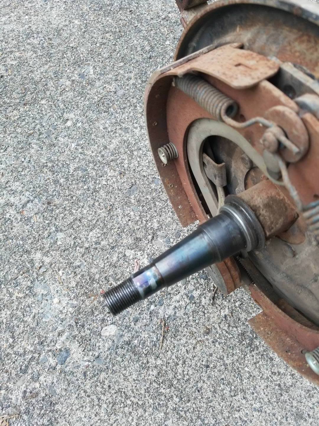

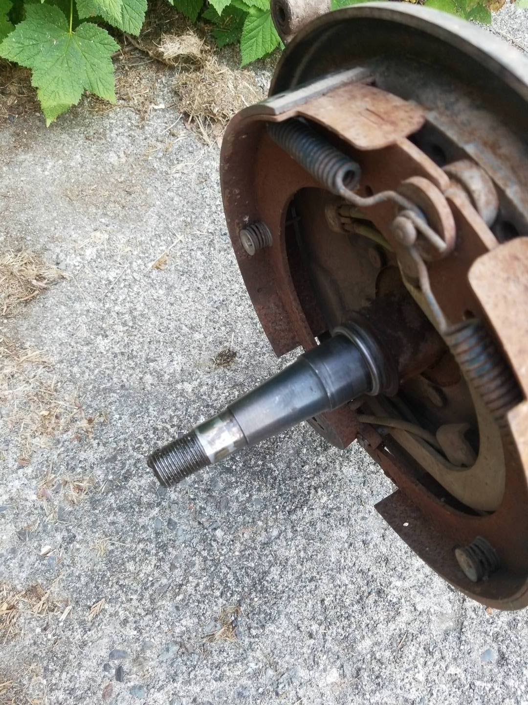

I also noticed that the axle spindles have some discoloration, including some blue in spots where it must have gotten hot at some point. The spindles are still very smooth and the PO repacked the bearings so those are practically brand new. The pictures below show the discoloration on the spindles. Is it still safe to use this axle with the discolored spindles?

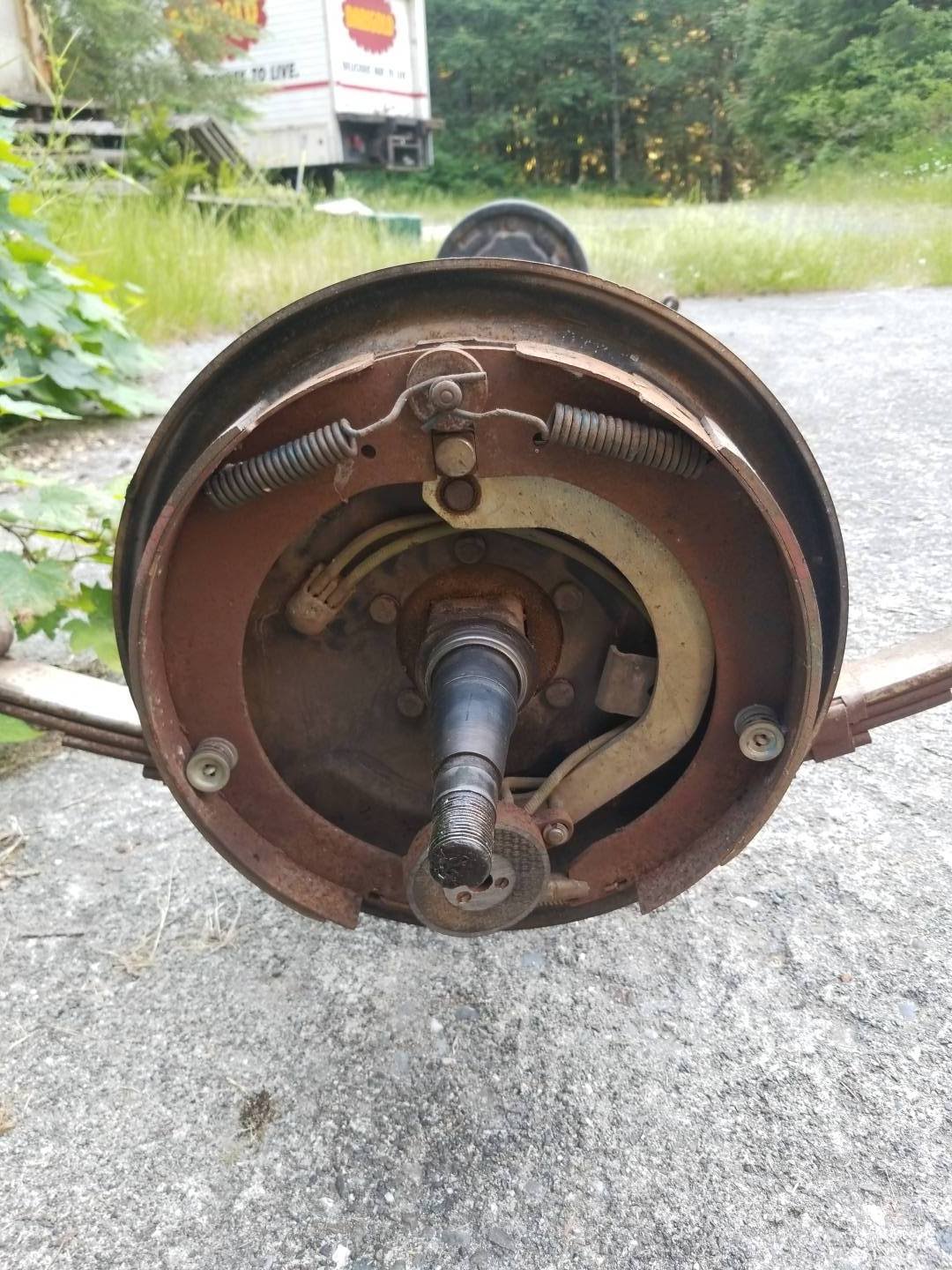

Finally, the original brakes are still on the axle. When we picked up the trailer, the wires to the brakes had been cut, so I don't think they've seen much use. I used a 12v battery and was able to confirm that they do indeed work though. However, I have noticed that something seems to be rubbing slightly inside the hub as the wheel goes round. The wheel spins fairly freely but I can hear what almost sounds like maybe the brakes hit at certain points on the drums. It could be that I need to just adjust the brakes a bit, but I'm not quite sure yet. But would you all recommend keeping the original brakes or swapping them out with something more modern?
