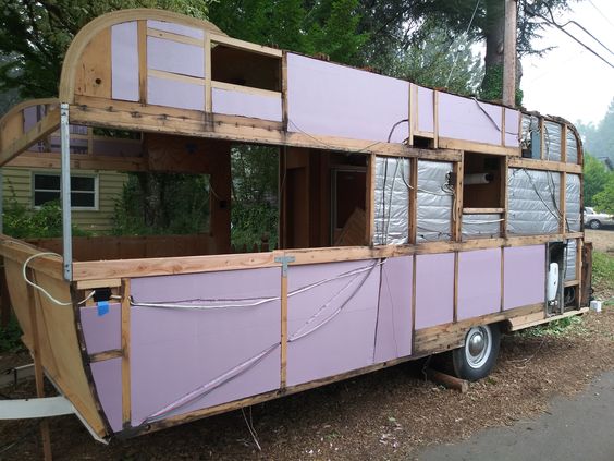

Post by Kyla on Oct 17, 2020 15:22:50 GMT -8
Clarification? I'm tucking foam board insulation into the framework. See pic (work in process) below.
Do I need to cover it all with Refectix for a vapor barrier?
Thanks smart people!
![](https://i.pinimg.com/564x/2e/c1/8b/2ec18b4f1ef08b1714a3bc67353f14d9.jpg) below.
Post by vikx on Oct 17, 2020 21:09:05 GMT -8
It looks good! just be sure to keep it tight and caulk any gaps. Also, the wiring should be on the inside with the grooves for them on the inside. It's not too late to redo that part... The wiring could easily rub if on the outside.
Also, the silver stuff may already be a vapor barrier.
Kyla
Posts: 40
Likes: 4
1963 Kenskill
Post by Kyla on Oct 19, 2020 13:22:13 GMT -8
Thanks Vikx. The silver stuff is the old fiberglass insulation that I hadn't yet removed. Bummer about the grooves. Back to the drawing board.
Post by vikx on Oct 19, 2020 18:30:06 GMT -8
Is that a metal support at the front corner? Interesting...
