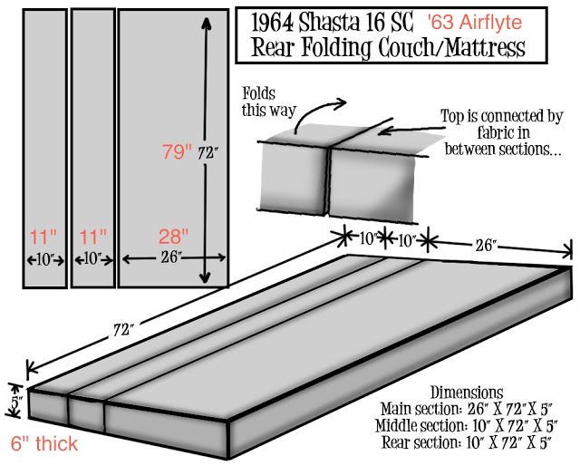

Found on Facebook and thought might be useful to someone here.

I've seen this floating around and have printed it for future use. Can anyone confirm if the Airflyte measurements are correct? And if they '63 would be the same as a '60?
