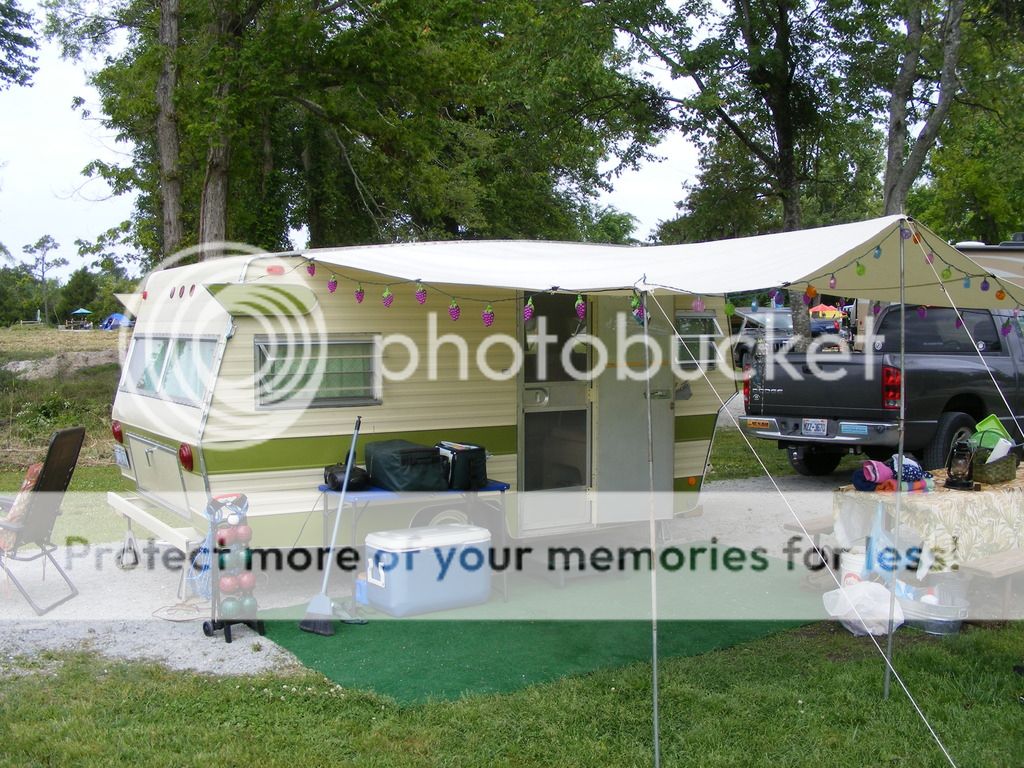

You will be glad to have it at that price. Down the road you will be thinking things like "I can't spend another cent on this trailer! Enough us enough"!! And you will be glad you already have the awning! 😂 What colour did you buy? I ended up going with the multi stripe green Screenshot_20170710-141709 by Bill, on Flickr That's a very smart looking awning.

So I sewed on the scallop just how it came, so it has about an inch seam on the under side. And the awning was about 8" too wide, so I altered just the corners to I could have 4" hanging down on each side. I decided that I am going to sew on a loop tab on the left side to help be able to pull the awning on the rail. IMG_1704 by Mel L, on Flickr IMG_1703 by Mel L, on Flickr IMG_1700 by Mel L, on Flickr IMG_1707 by Mel L, on Flickr IMG_1698 by Mel L, on Flickr IMG_1697 by Mel L, on Flickr
Post by ladywendolyn on Jul 16, 2017 16:47:03 GMT -8
This looks fantastic! Great work Mel!
Post by danrhodes on Jul 16, 2017 17:06:26 GMT -8
That awning is tutorial worthy. Maybe a sketch of what you did?
