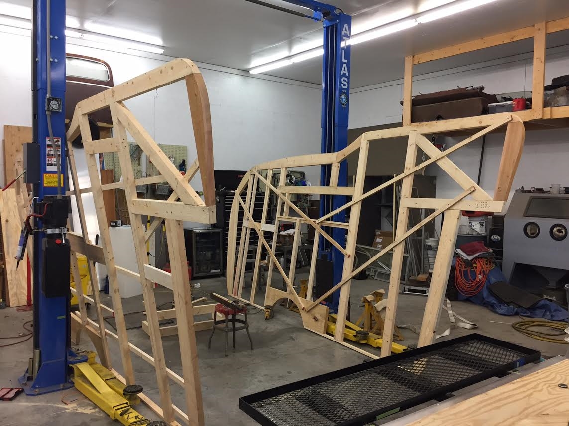

OK, trying to upload picture from my hosting to see if it works. This is the two side walls ready to start adding to frame.

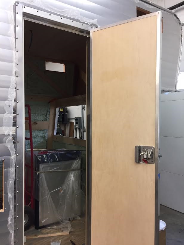

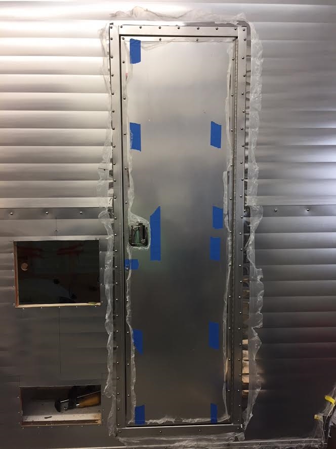

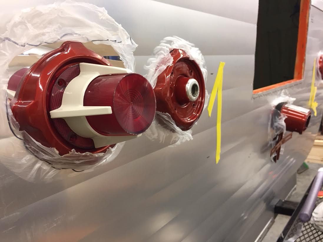

Been working on Shasta and Suburban off and on at the same time. Here are a few pictures of the work on the door and as you can see the drip rail is done. Also got the tail lights painted. I am using 1963 Mercury Comet taillights painted to match the colors on Suburban. The center taillight is an extra I had for the Suburban, it is for license light. On the door I had a local machine shop bend an aluminum threshold. the rest of the door frame I put together from aluminum. The hinge is a 6' by 1-1/2" x 1-1/2" aluminum continuous hinge.
