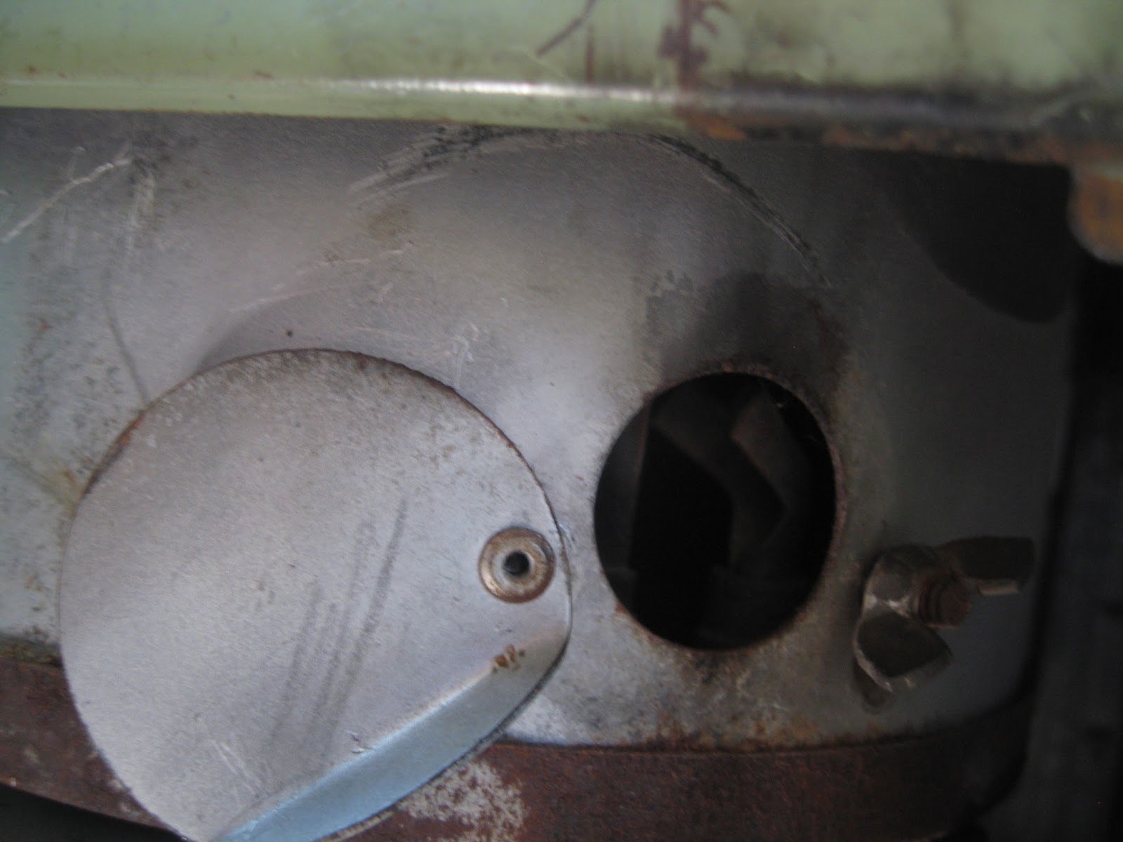

I would definitely not try to light the furnace before it is cleaned out. The wasp nest won't just burn up and could start a real chain reaction.
You may have to pull the furnace and really take it apart to clean it. I had one years ago filled with thousands of tiny bugs. What a mess! After cleaning (air blowing/vacuuming), it did work.
Is there any way to take a picture of the nests? Might help us help you.

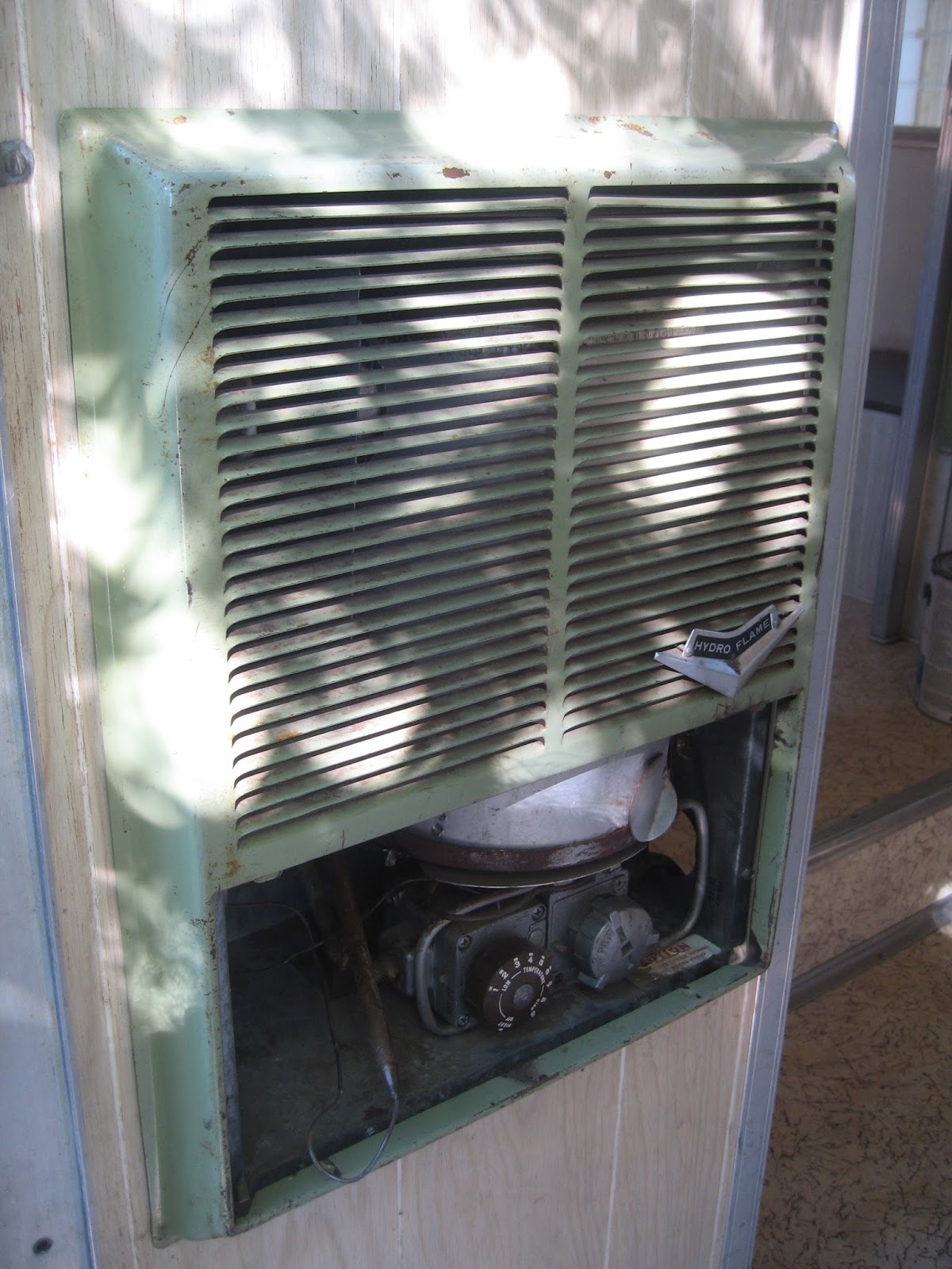

Ok, here are the pictures ~ This is the hydro flame with the access panel removed, the outside vent & intake, with the cover removed, & the hole where the wasps & a mud dobber set up housekeeping. Tony was able to remove the all of the nests from that hole, but because the wing nuts are rusted into place, he has not yet been able to free up the furnace itself to take it out (despite the generous use of WD40).

Well, once all cleaned out, we figured out how to start the furnace up ~ believe it or not, the instructions were on a little metal placard on the inside of the box ~ we thought that was just a UL approved sticker, but no, it's actually the model number & the instructions! Good to know, good to know. So here they are, for anyone else that has this Hydro Flame furnace, from 1968.
See it? Way over there in the corner, on the left side, turned sideways, looking like UL badge or something? Written too small for actually reading? Yah, we missed it, too.
Here it is, close-up, & turned so that anyone can read it.
Hydro Flame Furnace, Model number ARS-10L.
It is supposedly quite the heater, but it's a radiant heat, so it's not blowing the heat anywhere, it's just sort of warm over by the door & dining area. I guess they figured the kids would need the heat, and the parents could keep each other warm. :-D
