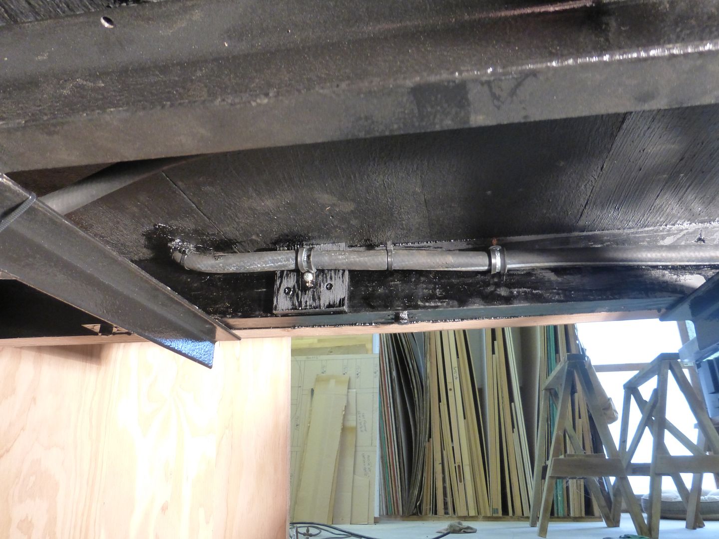

I described this elsewhere in a similar post. Drill your hole as large as you need to get the lines through then take a block of wood and drill a hole the size of the line all the way through it, next cut the block in half right through the hole next place both pieces around the tube below the floor and screw them to the floor. usually a 3/4" block about 3 or 4 inches square is fine. This will give you a very secure entry, then I go inside and fill with silicone caulk. This stops rodents, ants, spiders, and such from entering. Cheap, easy, and effective. That's a great technique bigbill, I have used it many times around the house for plumbing stub-outs. I wanted the underside lines high and tight, so I tried to get fancy with my tubing bender, the results being so-so. The tight bends didn't leave room for the blocking, and for appearance, I didn't want to block the lines on the inside. Besides, I wanted the interior fittings right on the floor, which didn't leave room for the blocking. Here are a couple pictures of what I ended up with: The hose is a combination of automotive heater and carburetor hose, stuffed up into the hole, level with the interior vinyl flooring, sealed on the underside with roofing mastic. The fittings were left exposed for ease of access and inspection. Doesn't look pretty but is an improvement over the original work which looked like it was done by a third grader.
