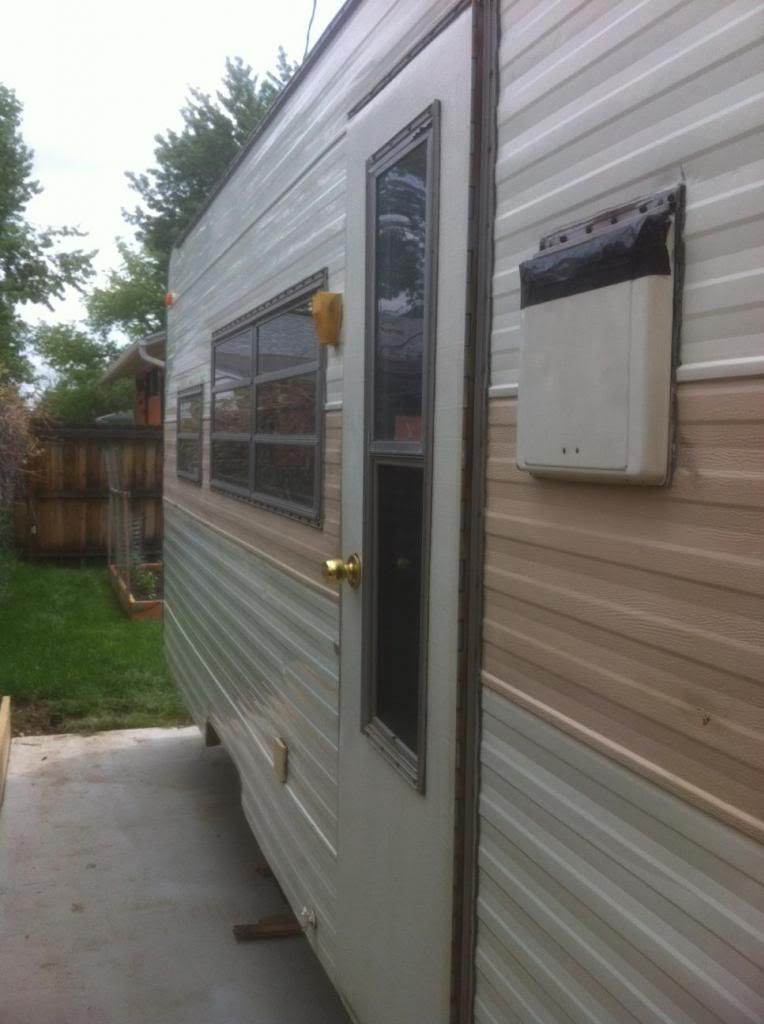

Thank you... Any info on Teton Logo? or where I could find it? Just replaced all the screws with self sealing stainless and put a rub rail across the bottom... Next we are replacing all the cushions and covering them... They are the original and rotting. Would you know where one can get 5 inch thick foam at a good price in denver co, or online? Any help appreciated... Houdini

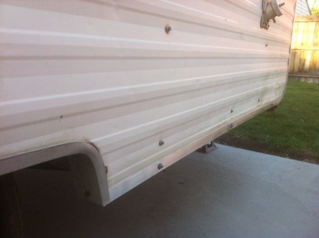

Post by houdini on May 4, 2014 5:58:43 GMT -8
Rub rails and some of the damage i fixed. Still needs more but its a start,,,,

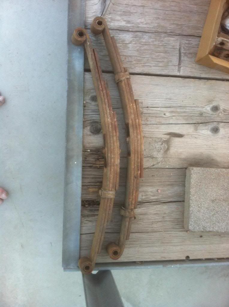

another day... more work. Went and had Colorado State Patrol this morning to get a vin and title paper work. Wife followed behind. Got there and she said trailer was leaning to the left...Long story short. Replaced the leaf springs. As you can see they were shot. Totally flat. Found a new place in Sheridan Co that does nothing but trailers and picked up a new set with all new brackets. 2500 pounders... Amazing. Gained 2 inches in clearance and my body wants to leave me... This is sooooo fun to do. Thanks all on this site for the support. attached are some pics...

another day... more work. Went and had Colorado State Patrol this morning to get a vin and title paper work. Wife followed behind. Got there and she said trailer was leaning to the left...Long story short. Replaced the leaf springs. As you can see they were shot. Totally flat. Found a new place in Sheridan Co that does nothing but trailers and picked up a new set with all new brackets. 2500 pounders... Amazing. Gained 2 inches in clearance and my body wants to leave me... This is sooooo fun to do. Thanks all on this site for the support. attached are some pics... Hey there - Can you pass on the info for the place in Sheridan, got a feeling my springs need replacing as well. Thanks much in advance!

The place is called Vital Parts. It is on 2028 west hamilton place... just around the corner from Corvettes Only. Phone number is 303-789-2549. Nice folks.. H

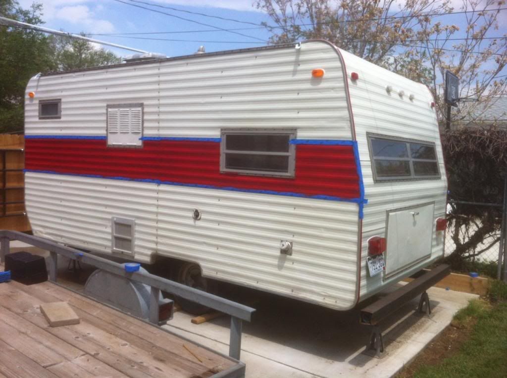

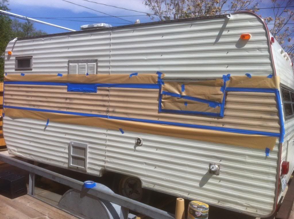

Started the paint... First coat on... All day prepping and paint... Primer done. first coat First coat drying... tomorrow we start anew.... Led Lighting inside and out... Fun Fun Fun...
