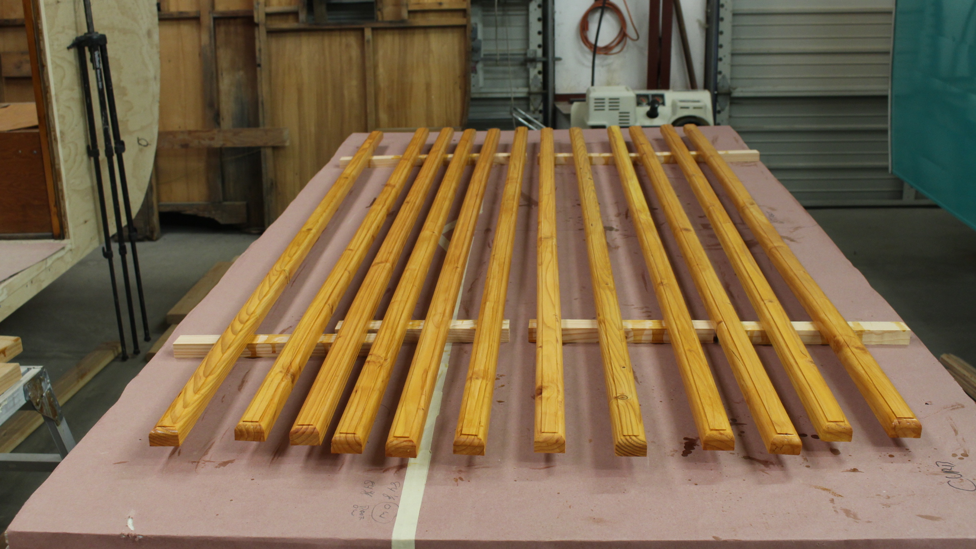

This is exposed roof/ceiling framing which will also cover the seams in the wrap for the 47 Mainline. I milled these myself out of dry doug fir 2x4s. They are 1 full inch thick and 1.5 inches wide. I couldn't find any full one inch thick material anywhere so I just made them myself using the cheap Harbor Freight 12 inch table saw, the cheap 10 inch HF chop saw and the cheap Ryobi 12 inch planer. To get the detail I used the cheap HF Router. This is the first of 6 coats of shellac.

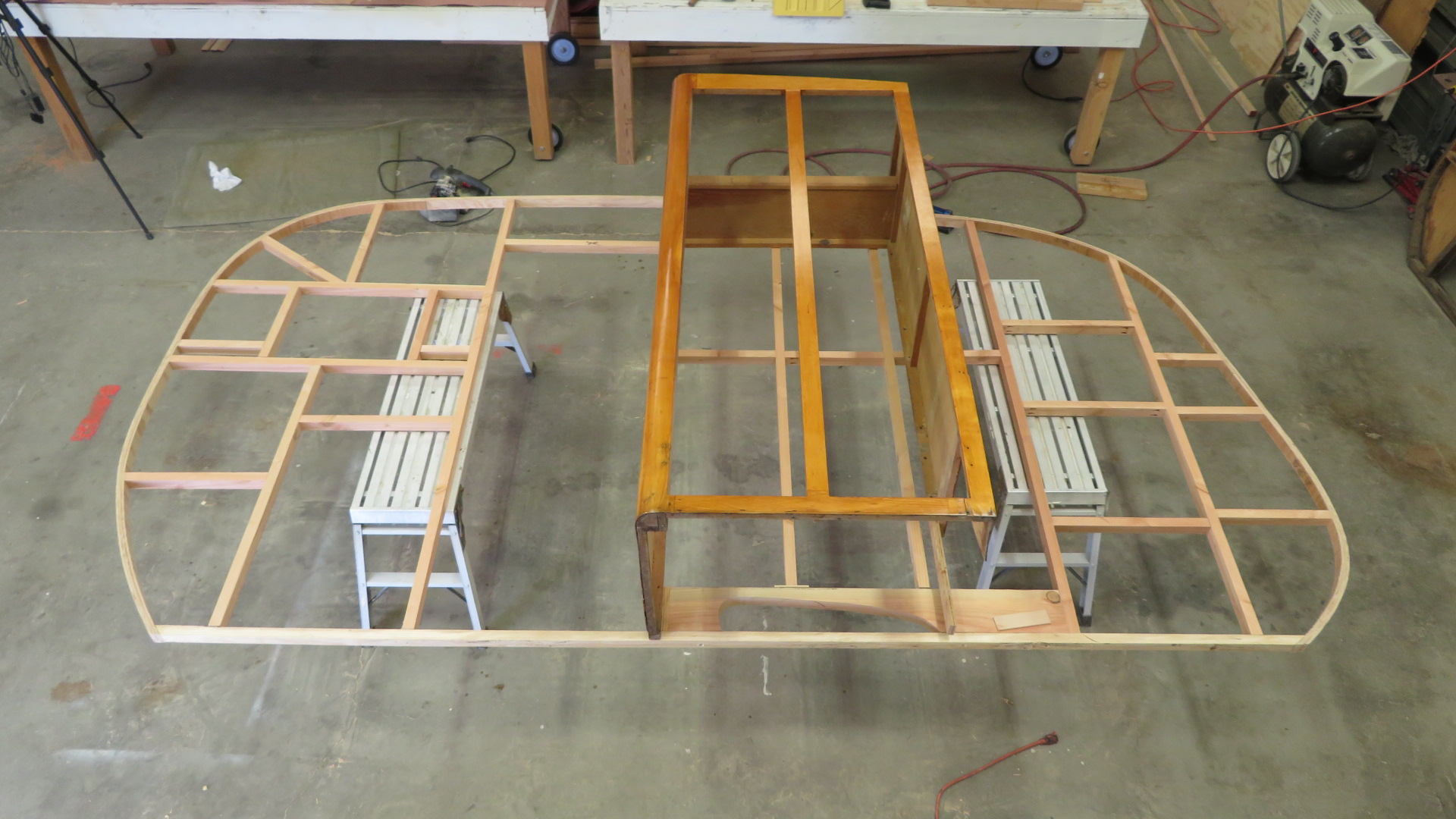

Got the curb side wall framing of the 54 Jewel finished. In this photo I'm testing the accuracy with the floor to ceiling cabinet next to the door. I missed a bit but an easy fix. My students are watching me rebuild this trailer. It's our class project.
